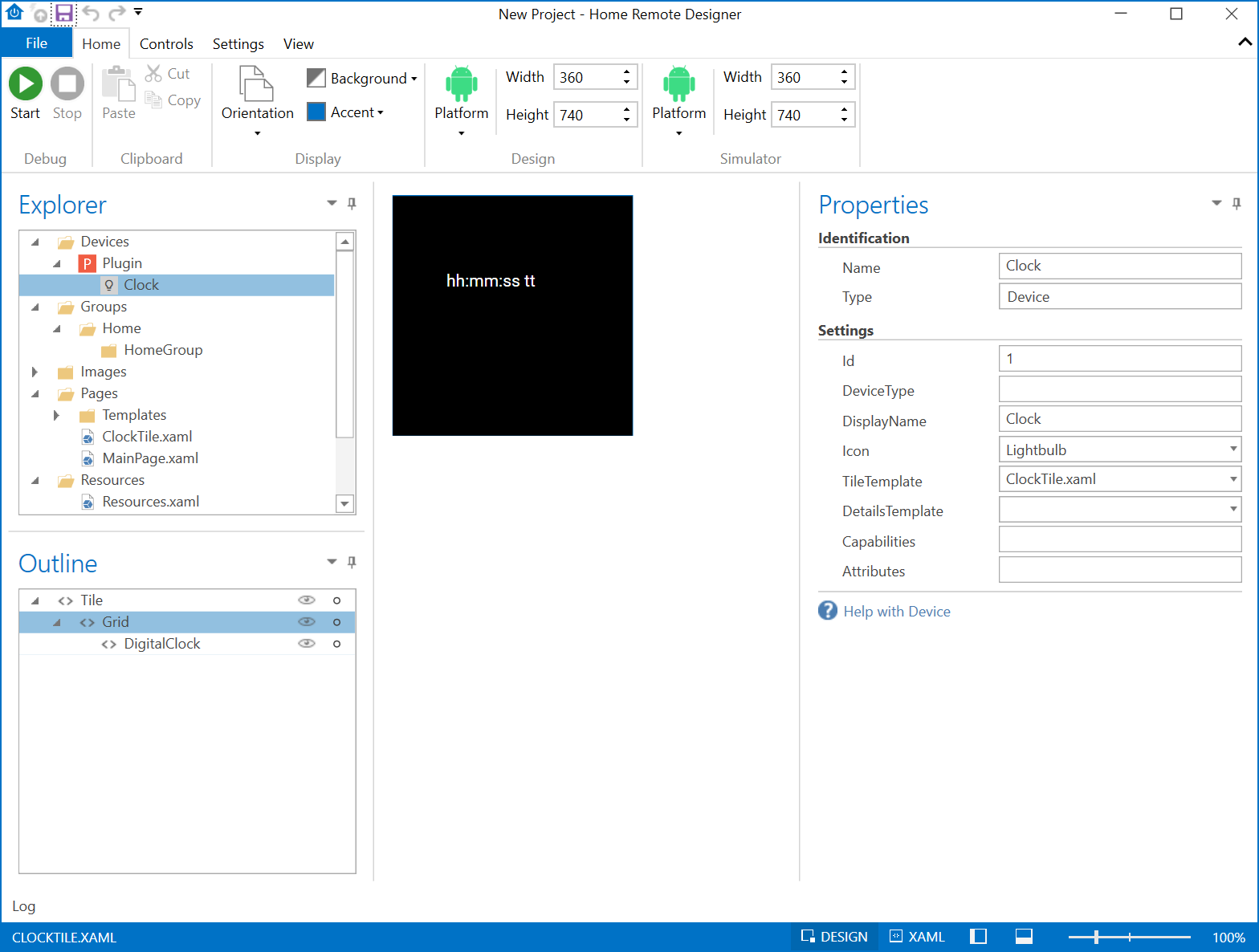

I need a bit of direction with adding a new tile to my HR project. I have been modifying the pre installed design that was put in when I added hubitat as a device. Now that I’ve figured out most of the simple things with properties, events and triggers. I would like to add a tile to a preexisting group with a clock control, a label and icon. Can this be done? I did see one post about creating and using a plug-in, would this be a good way to go or is there a simpler way?
Thanks in advance, Dan
