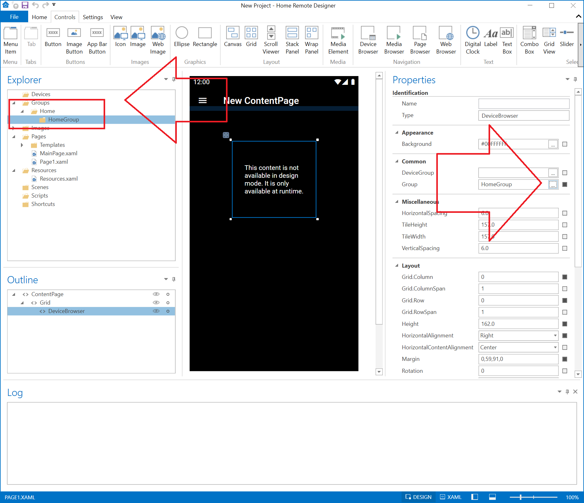

So, how do most people set up their groups?
Groups are in the Explorer pane. Drop a DeviceBrowser
control onto your page. Then set the Group
property on the DeviceBrowser
to the name of your Group
that’s shown in Explorer.

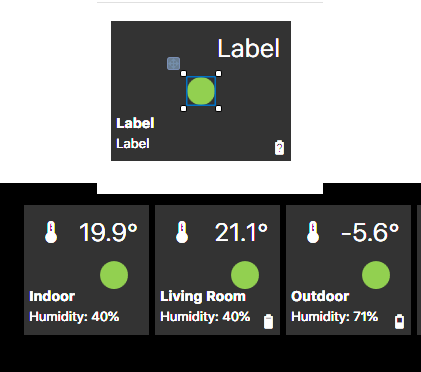

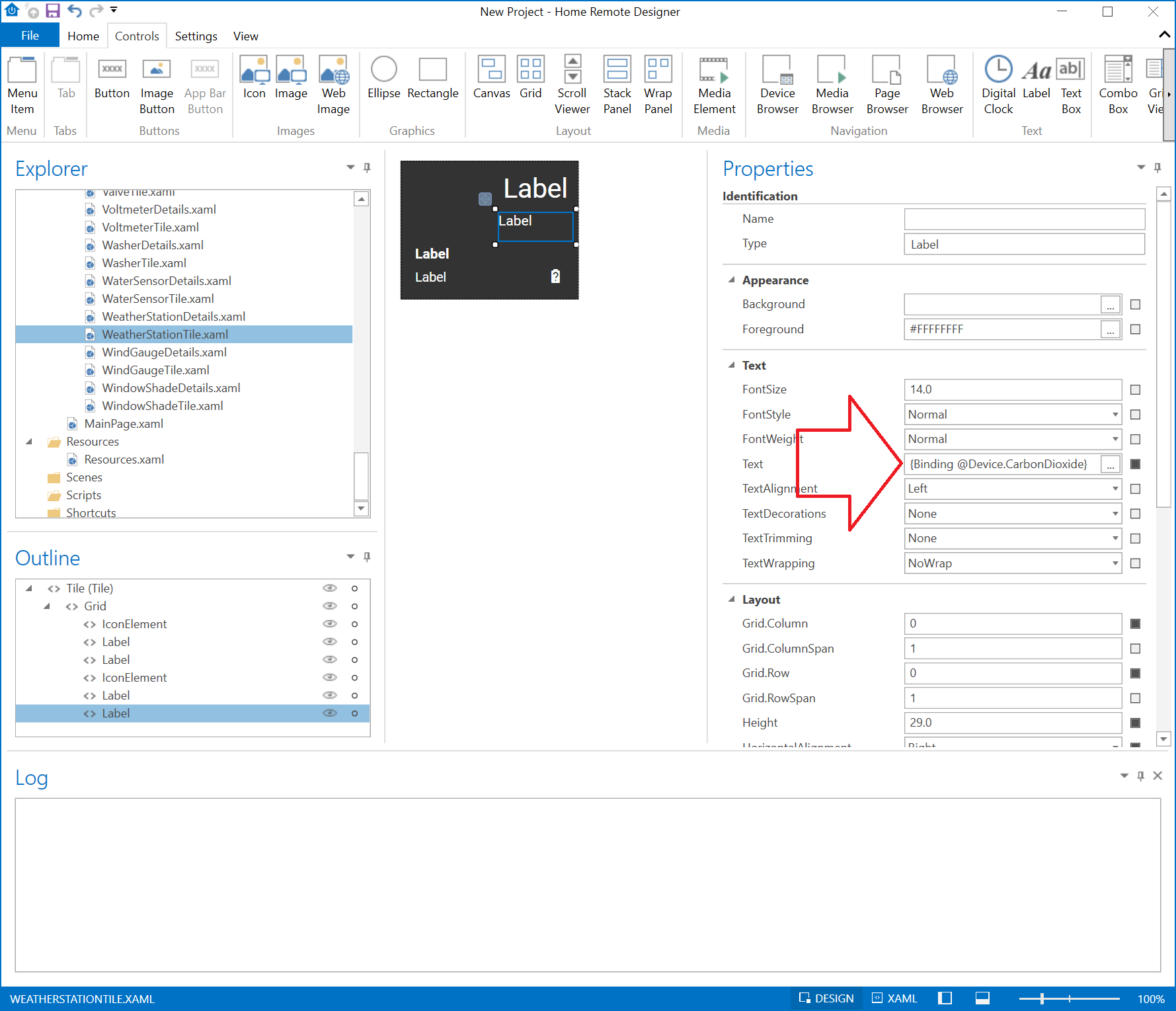

another question, with something like netatmo that has many capabilities, how can I show the c02 measurement, or any individual capabilities on the same page with the default temperature?
You can add additional Labels to the templates. Just set the Text
binding to a value of @Device.ATTRIBUTE_NAME
. The CO2 attribute name is CarbonDioxide
The only reason I didn’t include those on the default tile was that I thought it didn’t look as nice. A little too busy for my taste & it didn’t follow the same format as other tiles. I did include them on the Details page though so when you click the tile you should see the other readings. Again, you yourself are free to edit any of those XAML files in the Templates folder.

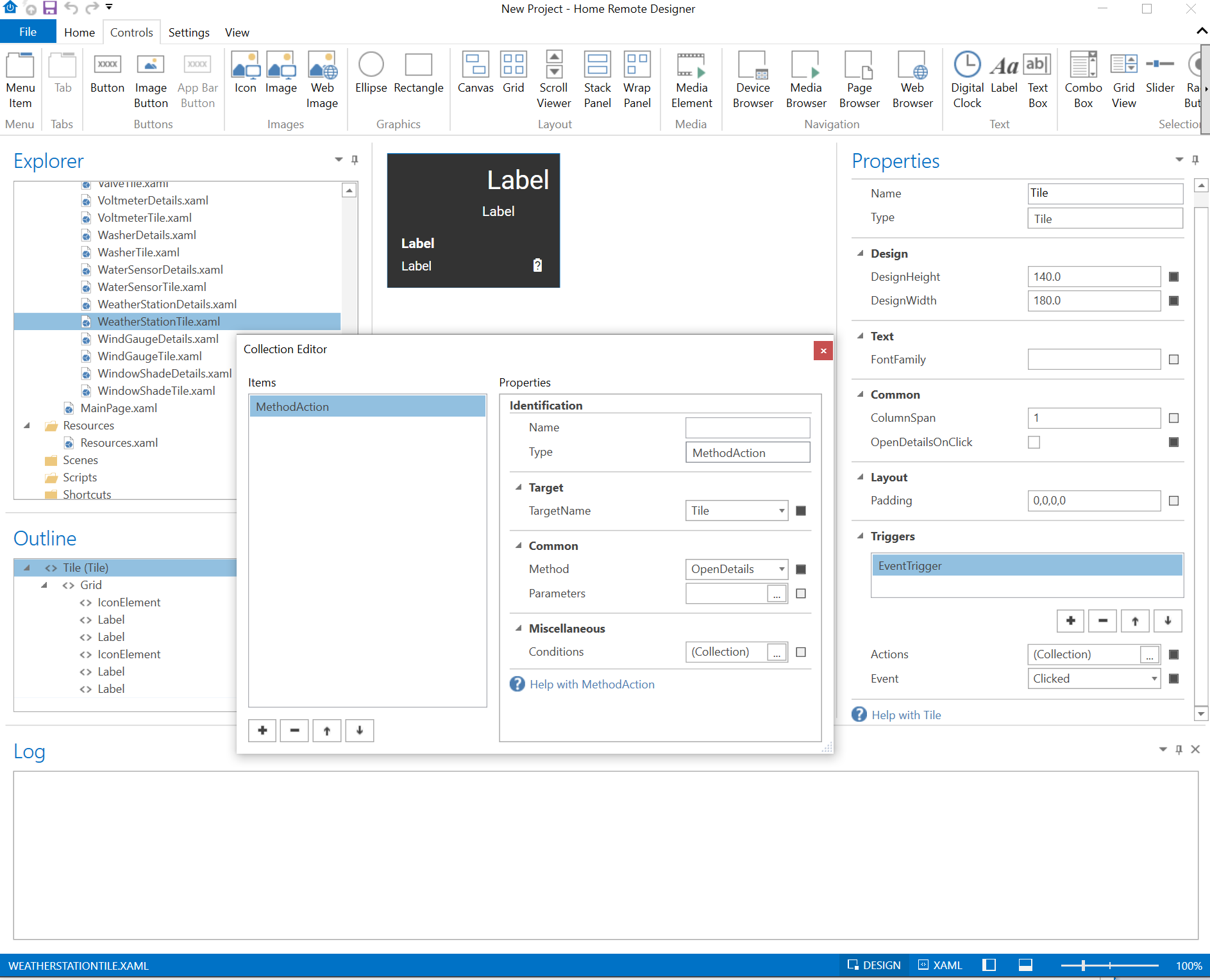

Also, are the details set to popup automatically on click? If so, they are not for me in the emulator.
Copy & paste the device object in the explorer. I’m not talking about the entire Netatmo integration, but rather the individual WeatherStation device object itself. For your duplicate device, assign it the CO2 tile. Then you should be able to add both devices to the same Group.
If you are using a DeviceBrowser, clicking most tiles should open the Details page. I say “most” because it really depends on the device. The WeatherStationTile should open the Details page. If you look at the Tile Clicked action, it calls OpenDetails

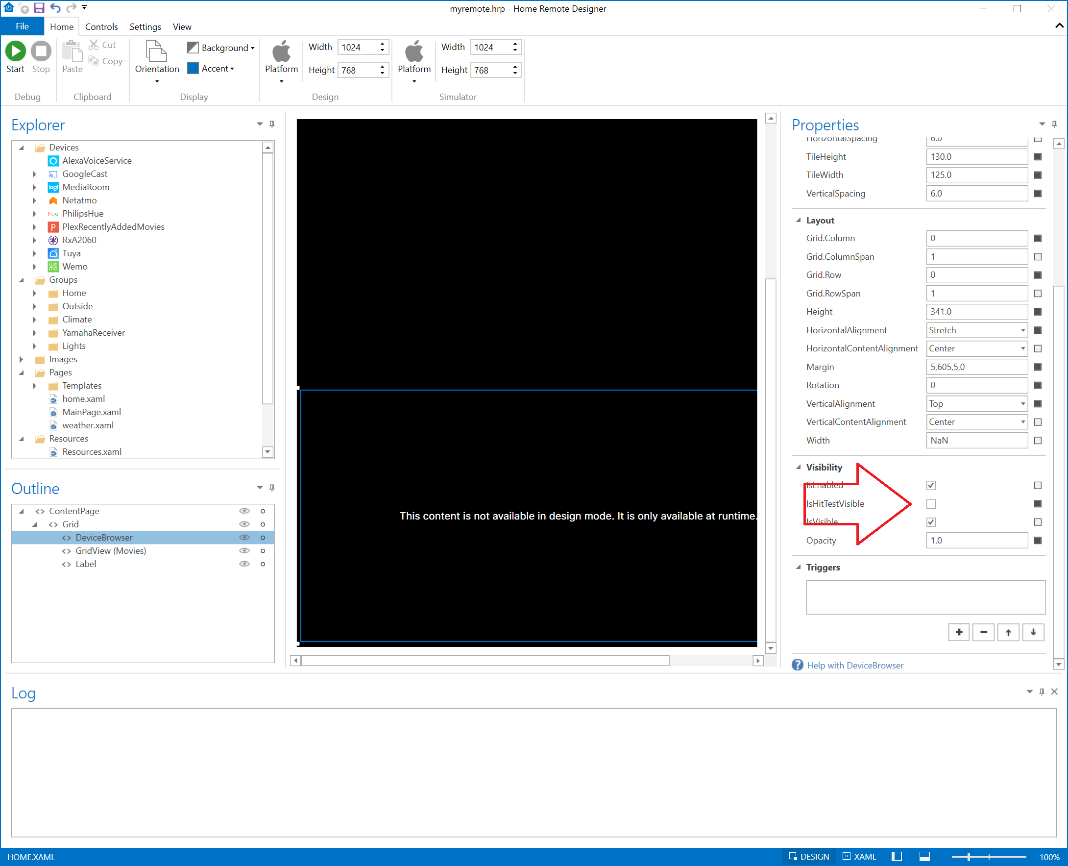

Ya, I have all that for the event trigger, yet nothing happens.
What you have should work then. Send me your project & I’ll take a look. My email is support@thehomeremote.com
You’ve got IsHitTestVisible
unchecked on the DeviceBrowser
. That means the entire control is going to respond to any click or touch events. You should check that property.
ahhh, thank you. Should start an FAQ section with some stuff in here.
