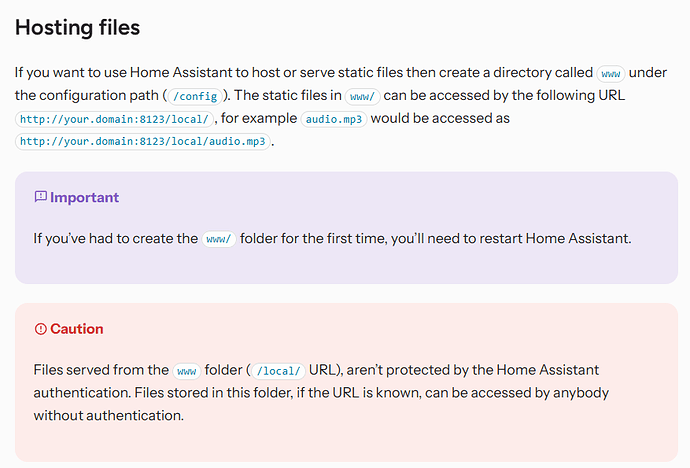

A second option would be to store the data on a simple Python web server and have the plugin read it from there.
step 3, HA devices ARE NOT available to plugin see the author response specifically to an OP quesion
