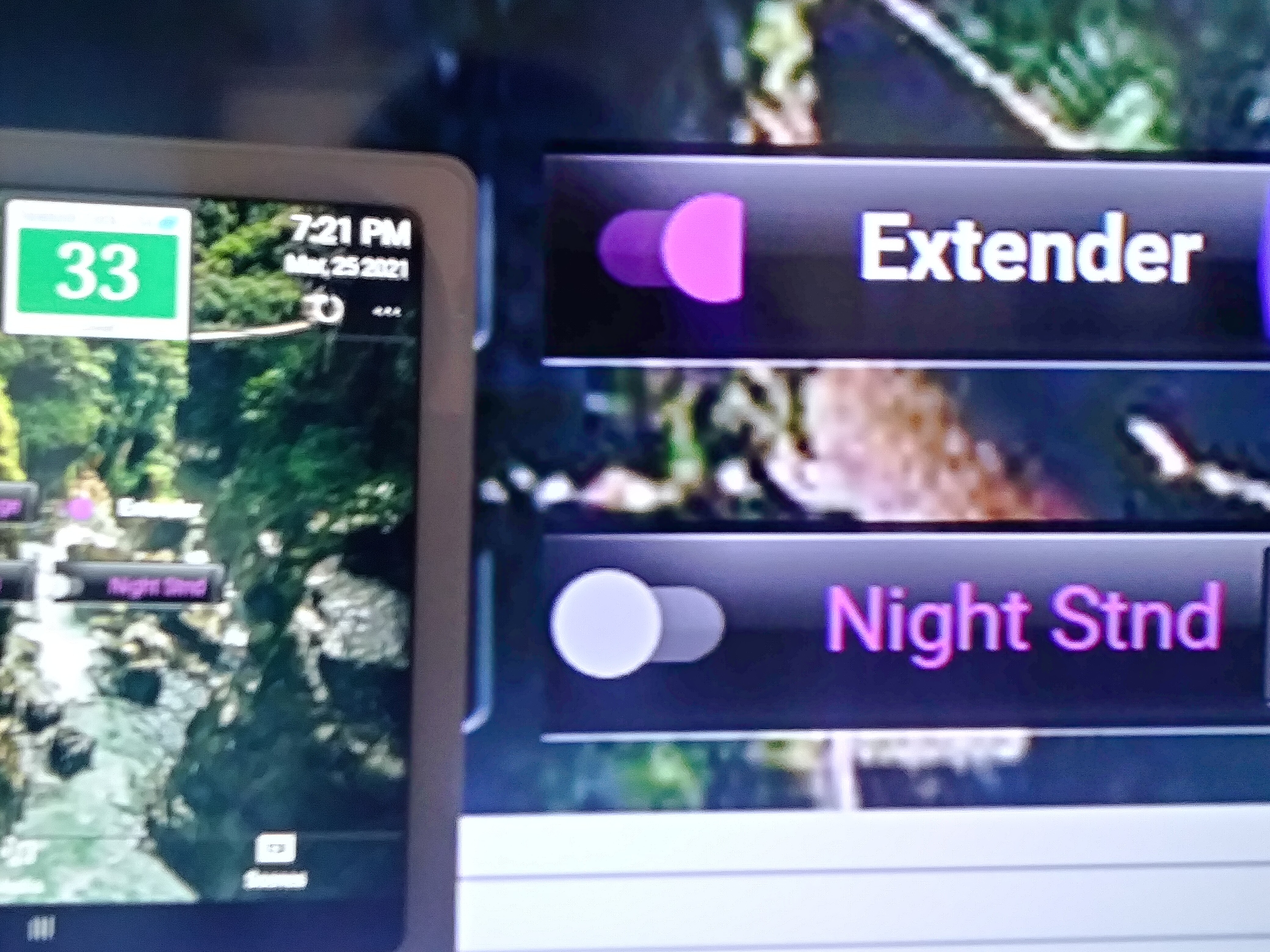

Can someone tell me why this works fine in the designer but not on my tablet? Samsung A7 tab. Deign and simulator same pixels as tablet.trying to make it a one hit toggle.1616721589810489413804|666x500
Does the same thing happen on the night stand button?
Yes. All buttons that are bound @Device.Switch
Ideally I wanted the button to perform the actions of a toggle but couldnt make it work. So I added the toggle to get the action.
Have you followed all of the steps in this video?
Setting up a Toggle for a Button or ImageButton is no different than a ToggleSwitch. Just be sure to change the ButtonType property to Toggle.
That is how I got to this point and things worked in a basic set up. Of course I wanted a more professional set up of making cooler and barowing other people’s designs to make it simpler as i add devices. The designer works and looks like it should but the tablet is just missing the “selected” image. I could get the light trigger just fine in the details but when I tried moving it to the tile itself is where this problem arrose. Yes I unchecked the open details on click. Ill revisit the video as its been a few months.
So the image is disappearing when the button is toggled on? But it looks fine when it is toggled off? Is that what the issue is?
I just want to be clear I understand what’s going on.
If you could, create a test project with only a single button & then upload it. That way we can take a look & see/test exactly what it is you are doing.
Yes that is what is happening. I noticed I was using image button instead of image element. I have replaced it with element but the designer keeps crashing… Put all the triggers from a toggle into the element. I can upload a file from my original setup but like I said works as it should in the designer turning off and on physical insteon light and updating the image to a “selected” state just not on the tab. Appreciate the help!
