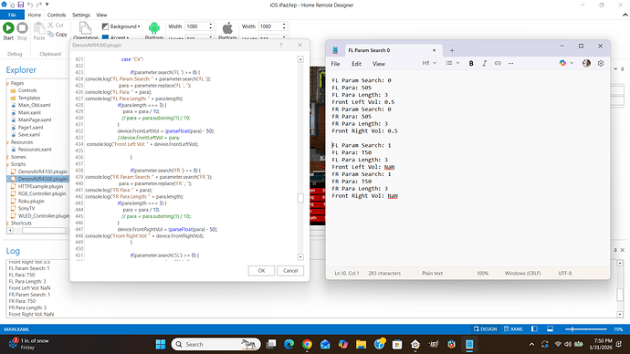

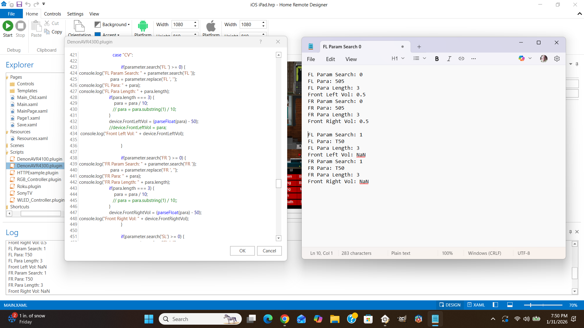

So, I’ve been poking around the plugin attemptng to find the remedy for the above change in the 4300H protocols. I know where it’s happening but not why. In the screenshot, you’ll see the code (unaltered) with some console.log entries for my tracking on the left and the output in the console on the right. Question: The “T50” in the second pass seems to be coming from the “TFL” param. Not quite sure how that’s happening. Where should I be looking? Thanks.

In order to remedy the situation, I changed the code in the onPoll section under the case ‘CV’: section to the following:
if(parameter.search(/^FL /) >= 0) {
para = parameter.replace('FL ', ‘’);
if(para.length === 3) {
para = para / 10;
device.FrontLeftVol = (parseFloat(para) - 50);
if(parameter.search(/^FR /) >= 0) {
para = parameter.replace('FR ', ‘’);
para = para / 10;
device.FrontRightVol = (parseFloat(para) - 50);
