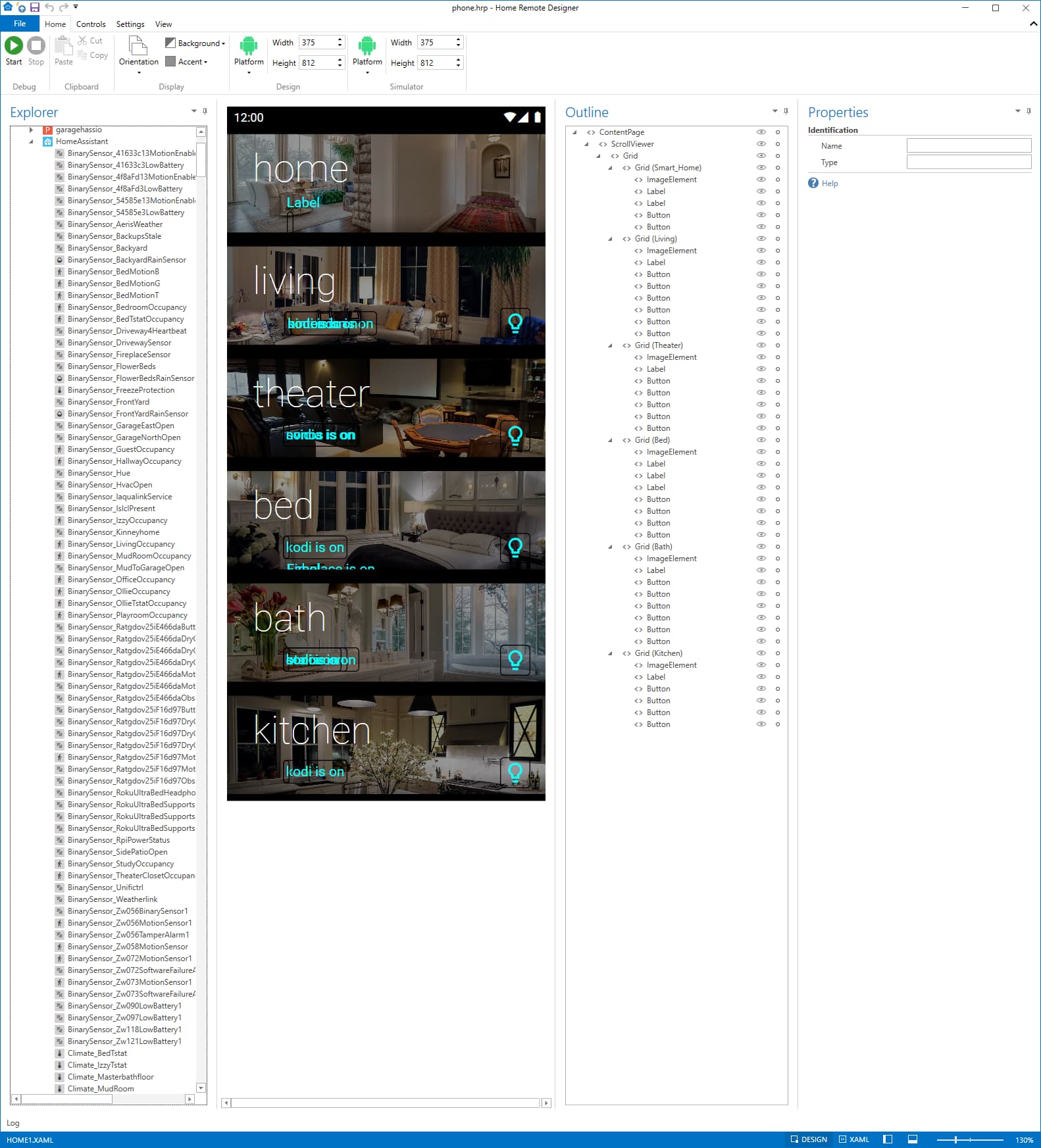

I am switching from Vera to Home Assistant. When I add the Home Assistant device source, it adds fine. But right after that I go to save the HRP file and get an Error pop-up with “There was an error generating the XML document.” Could I have too many items in HA (limit?)? Maybe it doesn’t like that some entities start with a number? Is there a log that would spell out the error?

So I found today if I start deleting HA entities in THR, it will eventually let me save the file. There doesn’t seem to be a repeatable pattern. It works whether I start at top or bottom, but I have to delete a few hundred entries. And a few times I had to delete all but a dozen or so. Still trying to narrow down what THR doesn’t like…
So I was able to swap out Vera for HA and finish my current project. After adding HA I was still unable to save, so I deleted all but the few HA devices I needed for this project and was able to save and then distribute to all our phones/remotes.
