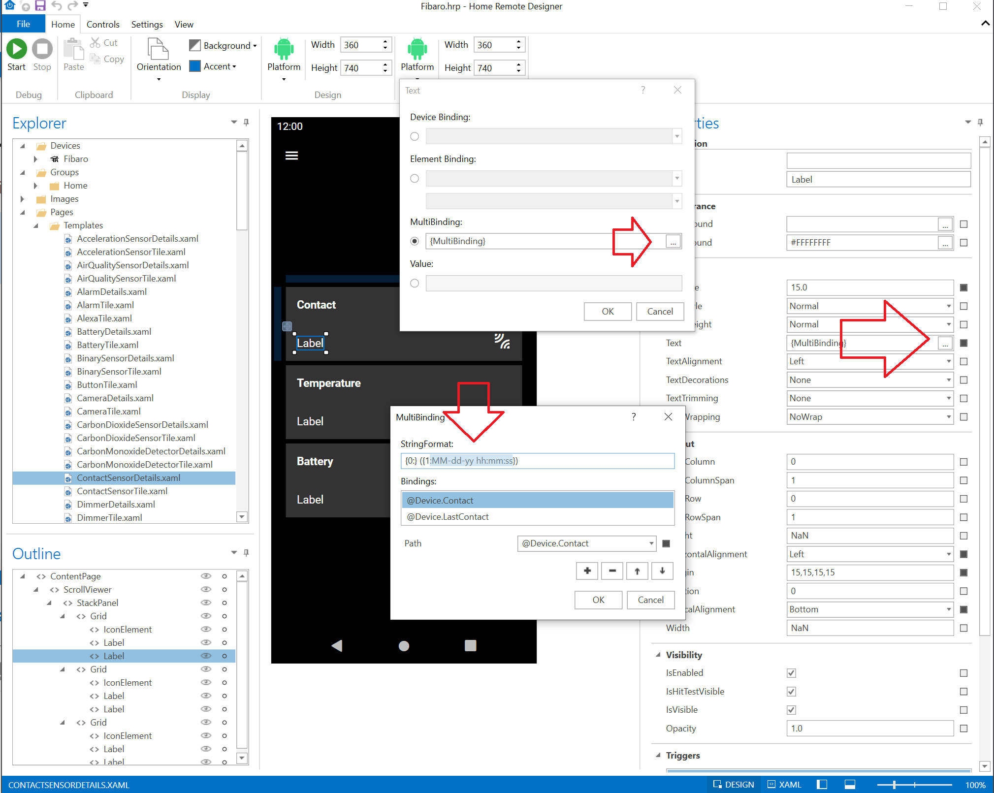

Yes. You can apply custom formats by using a MultiBinding. In the curly brackets, after the binding index number, add a colon followed by the desired time format. Any of the formats listed on the web pages linked below are supported.

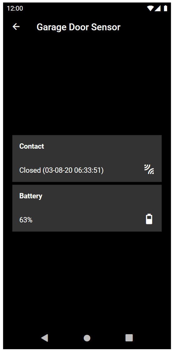

For these screenshots, I applied a format of MM-dd-yy hh:mm:ss to the control. 1: precedes that value because LastContact is the second parameter in my Bindings list. If it was the first parameter it would be 0:MM-dd-yy hh:mm:ss.
Hi Bill, thanks for the answer! Worked perfectly and goes to show again how awesome and customizable THR is if you know how to use it. Thanks again!
