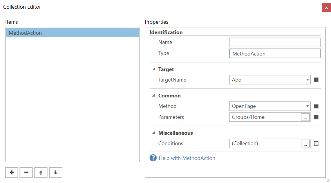

When I use GoToGroup I am unable to use my back button. Is there any way to use Groups for navigation and have back button functionality?

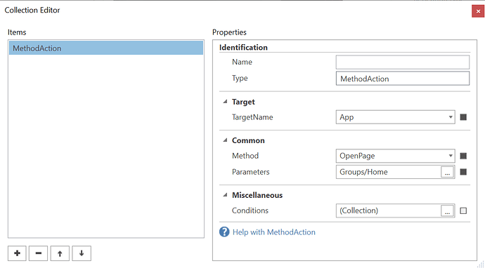

Yes. Call either PushPage or OpenPage & set the parameter to Groups/YOUR_GROUPCOLLECTION_NAME
All of the GoTo methods clear the navigation stack so none of those will present the Back button to you.
