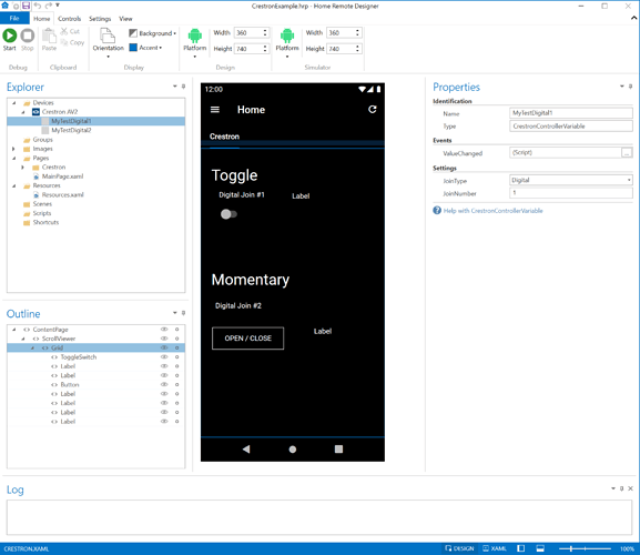

The Home Remote uses the Crestron Mobile symbol in a SIMPL project to talk to the controller. That’s the same symbol that the official Crestron Mobile & Mobile Pro apps use.
Attached is a small example that controls & reads digitals joins. Includes both a toggle & a momentary.
CrestronExample.hrp (4.5 KB)
