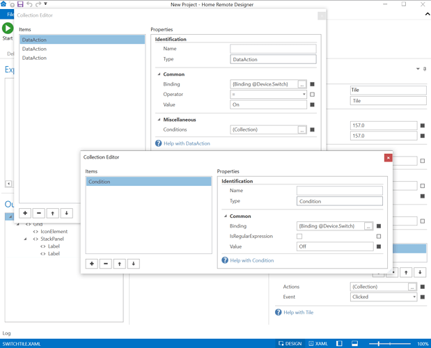

Currently it is not possible to add Conditions to an EventTrigger like you can with a MultiDataTrigger, but funny you mention it. The next release, 3.5.0, will have support for this. There will be a new Conditions property added to each EventTrigger Action. DataAction, DelayAction, MethodAction, PropertyAction, & ScriptAction will all have a Conditions property similar to that of the MultiDataTrigger.
For the time being you can use a script. I’ve wrote one for you that should do as you’ve sketched out. I recommend replacing this script with individual actions once 3.5.0 is released. It’s generally best to only using scripting inside XAML pages when absolutely necessary. Use the other Actions when possible.

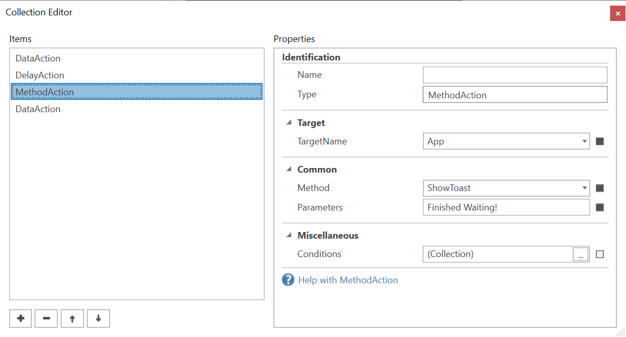

Domodial

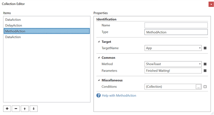

I just tested those 3 commands & they worked for me. To help troubleshoot, add step after your DelayAction that shows a toast message saying it has “finished waiting”. That’ll at least tell you the DelayAction is working.
