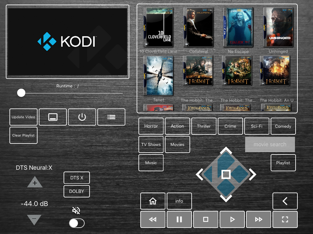

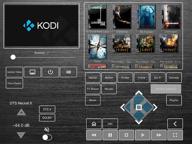

All looks good when I run in the designer. But on my ancient Ipad Mini running IOS 9.3.5 the gridvew images for the movies aren’t all the same size. Some like the 3 Hobbit movies are shorter.

The image size of the covers for Unhinged, Tenet and the 3 hobbit movies are all the same size. 2000 wide and 3000 high. Unhinged and Tenet show correctly, the 3 hobbit movies have changed the aspect ratio.
They all show correctly on the Windows designer.
These are all movies with long names which have this problem. The name of the movie is too long to fit in the space.
These format correctly in the Designer. But in the ipad app the full length text label is displayed first over 2 lines. Then the icon is drawn and the space for the icon isn’t big enough. It draws the icon smaller to fit in the space and then truncates the label to a single line. But the icon isn’t redrawn and ends up smaller.
