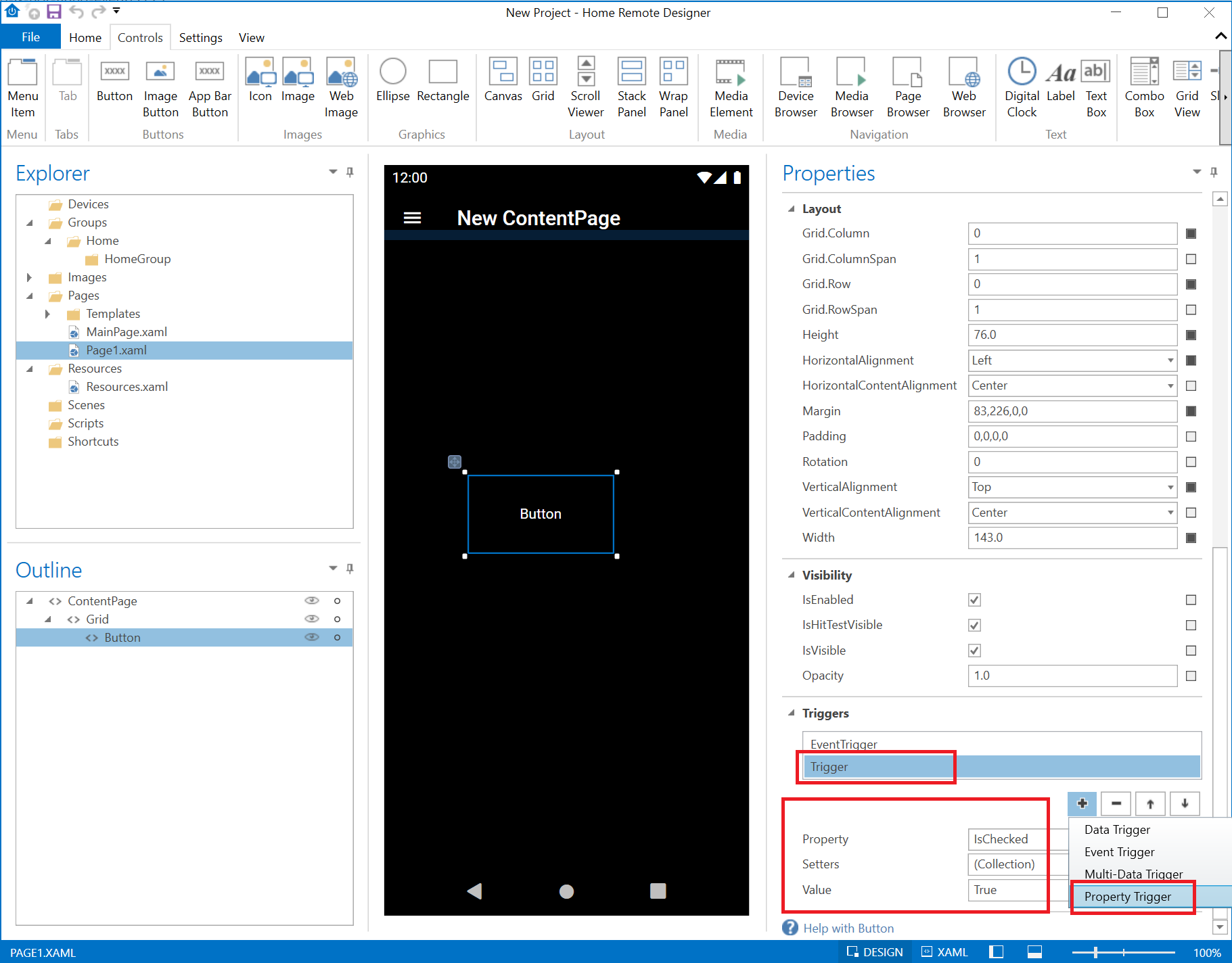

The root source for the Checked & Unchecked events is actually the button click event so you will not be able to get them to fire on button_B when button_A is clicked. Your solution here is to use a Property Trigger on button_B. From the Property dropdown, select the IsChecked property & set the Value to either True or False.

The IsChecked property trigger on button_B will fire regardless of how it was set. If that’s what button_A is doing then the IsChecked property Trigger on button_B should fire.
