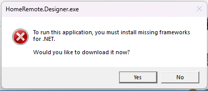

Got a new computer - Winn 11. Installed .Net 10 and installed Designer. I receive this when attempting to start the application:
Text is “To run this application, you must install missing frameworks for .Net.” Pressing “Yes” to download now does nothing.
Run all the windows updates, and/or download direct from Microsoft. I’m running a new laptop and windows 11. No issues.
Search the topics. Download and install .NET 6.0 Desktop Runtime (v6.0.7)
I installed the old version of .Net and designer started working. Thanks.
