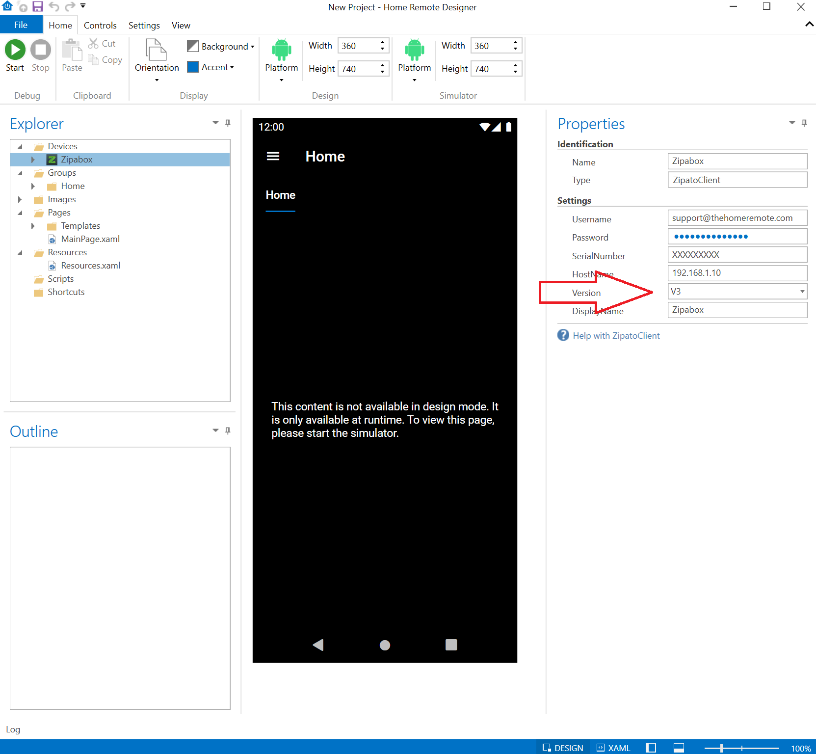

Hi,
This procedure not Work!
below the configuration image.
I’m actually working on Zipato V3 right now. Should have a new version posted later today. Maybe hold off for now. I’ll let you know when the update is available.
Designer version 3.2.0 is available. When you add Zipato to the apps or Designer it will include controllers from both my.zipato.com & my3.zipato.com
The Zipato source itself has a new Version property.
-When this is set to V2 it’ll use my.zipato.com
-When this is set to V3 it will use my3.zipato.com
