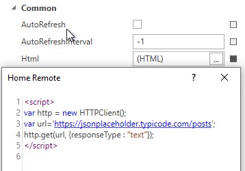

I tried
<script>
var http = new HttpClient();
var url='https://jsonplaceholder.typicode.com/posts';
http.get(url, {responseType : "text"});
</script>

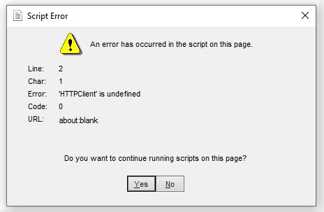

and get
'HttpClient' is undefined
Not sure how to define http in this context.
It’s HTTPClient, not HttpClient. It’s case sensitive.
I get a similar error.

The HTTPClient class is only available to Plugins. You can’t use it in HTML like that.
