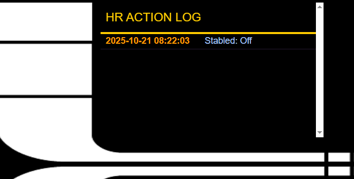

Okay, I had a relatively simple plugin created that writes the necessary HR data to a log file. This file can be displayed in HR in a web browser window (with the latest entries at the top).
I have put together a zip file that contains a Python program (LogServer.exe) that creates a small mini server. Please read the readme.txt file in the ZIP file.

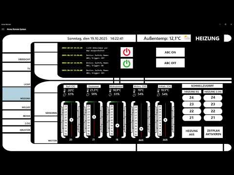

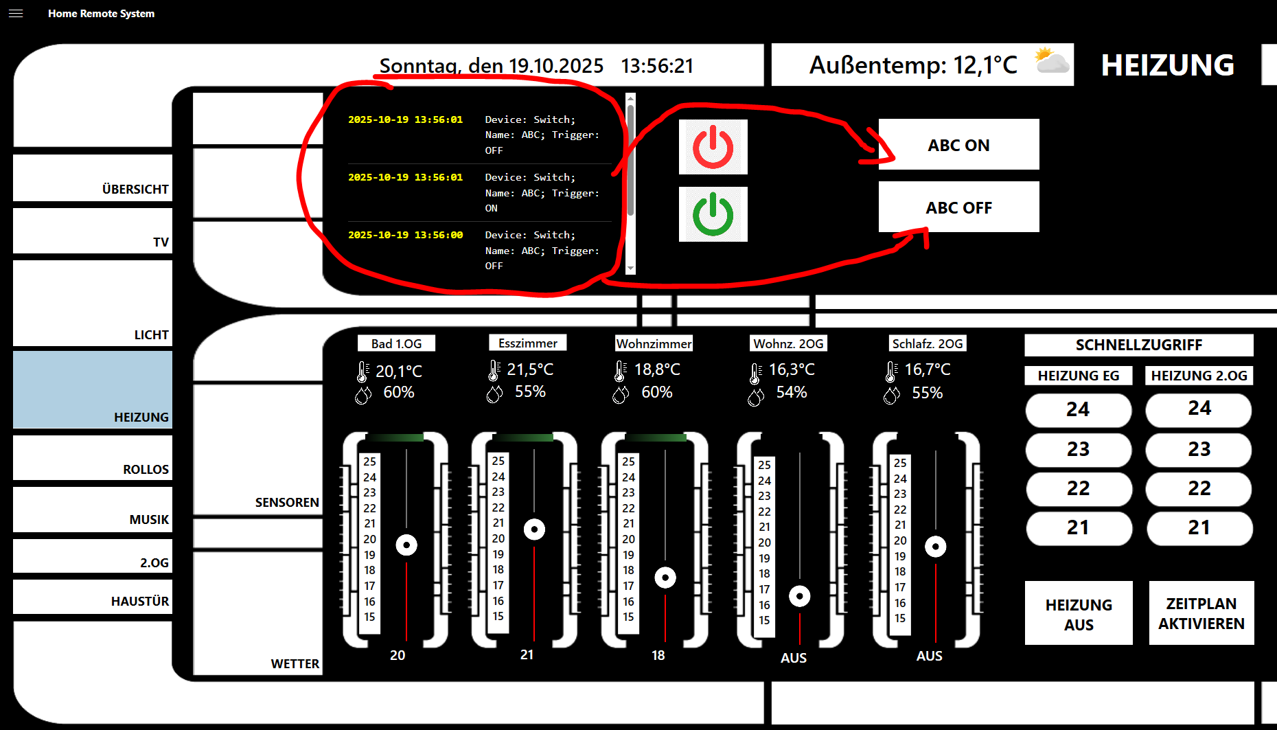

This is a picture from the dashboard how ist will be looks like:

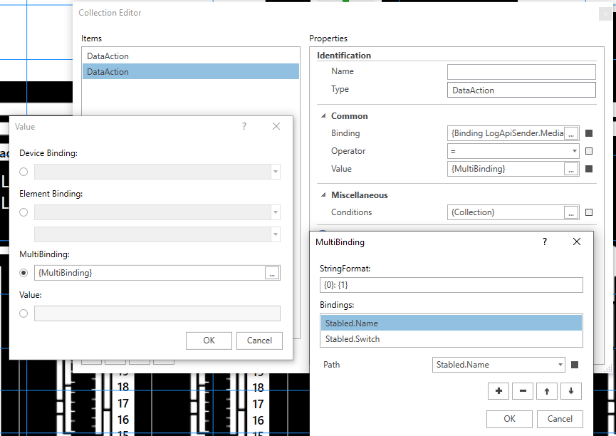

to assign this function to a button use "LogApiSender.MediaCommand and for value you can use any device binding or your own text - but multibinding makes the most sense for me.
here the result with multibinding:

here is a Video on YouTube from the Dashboard
