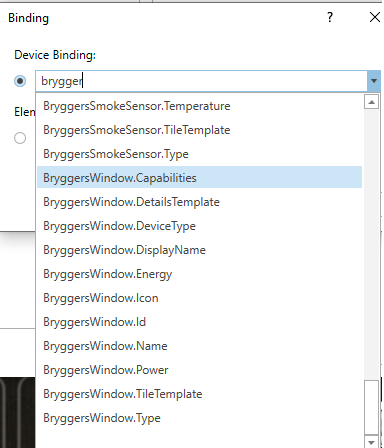

I am trying to control my shades and Window. using qubino Flush shutter dc. I am not sure about the bindings. It seem like i miss the level. ( I am using Fibaro HC3)
Does anyone know how to do this.

Can you please post the JSON for this device?
Open the URL below. Replace the IP address with your HC3 IP. Replace 191 with your shutter device Id.
http://192.168.1.27/api/devices/191
The Home Remote uses the type & baseType fields to determine a device’s capabilities. I’d like to see what’s in the JSON.

{“id”:232,“name”:“Window”,“roomID”:221,“view”:[{“assetsPath”:"/dynamic-plugins/com.fibaro.rollerShutter/assets",“jsPath”:"/dynamic-plugins/com.fibaro.rollerShutter",“name”:“com.fibaro.rollerShutter”,“translatesPath”:"/dynamic-plugins/com.fibaro.rollerShutter/i18n",“type”:“ts”}],“type”:“com.fibaro.rollerShutter”,“baseType”:“com.fibaro.baseShutter”,“enabled”:true,“visible”:true,“isPlugin”:false,“parentId”:231,“viewXml”:false,“configXml”:false,“interfaces”:[“energy”,“levelChange”,“power”,“zwave”,“zwaveMultiChannelAssociation”,“zwaveSwitchAll”],“properties”:{“parameters”:[],“pollingTimeSec”:0,“zwaveCompany”:“Goap”,“zwaveInfo”:“3,4,5”,“zwaveVersion”:“1.1”,“categories”:[“blinds”],“configured”:true,“dead”:false,“deadReason”:"",“deviceControlType”:54,“deviceIcon”:1026,“emailNotificationID”:0,“emailNotificationType”:0,“endPointId”:0,“energy”:0.0,“favoritePosition”:50,“log”:"",“logTemp”:"",“manufacturer”:"",“markAsDead”:true,“model”:"",“nodeId”:53,“parametersTemplate”:“0”,“power”:0.0,“productInfo”:“1,89,0,3,0,83,1,1”,“pushNotificationID”:0,“pushNotificationType”:0,“saveLogs”:true,“serialNumber”:“ZMNHOD1 H1S5P1”,“showEnergy”:true,“smsNotificationID”:0,“smsNotificationType”:0,“state”:“Unknown”,“switchAllMode”:"",“useTemplate”:true,“userDescription”:"",“value”:0},“actions”:{“close”:0,“open”:0,“reconfigure”:0,“reset”:0,“setFavoritePosition”:0,“setValue”:1,“startLevelDecrease”:0,“startLevelIncrease”:0,“stop”:0,“stopLevelChange”:0},“created”:1610029971,“modified”:1610029971,“sortOrder”:171}
Thanks for the data. I see the issue. This will be fixed in 3.17.0.0. I plan on uploading that to the stores later today.
Thanks wonderfull. and thanks for a very good product and service
3.17.0.0 is now live. You will need to resync your devices so the WindowShade & SwitchLevel capabilities get assigned to it.
Hi Bill
Thanks a lot., Its working
