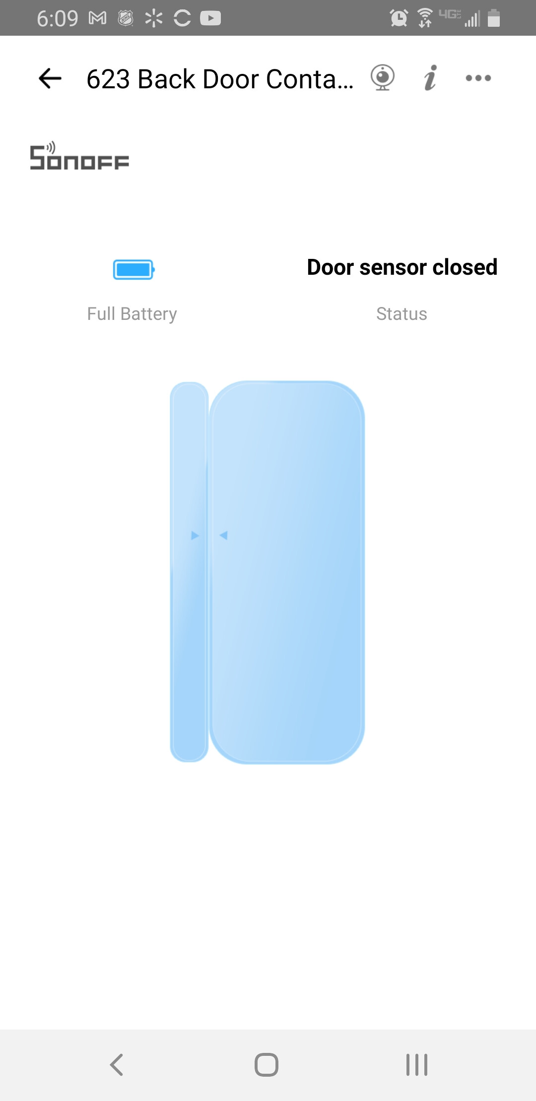

However it is indeed reporting back a bit of an unexpected value. It’s currently reading 3.103. I don’t really know what this means. I see in the eWeLink app it has a full charge. Not sure I understand the scaling they are using.

So apparently that’s the voltage. Your battery is currently measuring 3.103 Volts. I suppose I could divide that number by 3 to create a percentage. Guessing they all use a standard CR2032 3V battery.
Yes i see that, you know is using 2 AAA batteries totalling 3 volts
