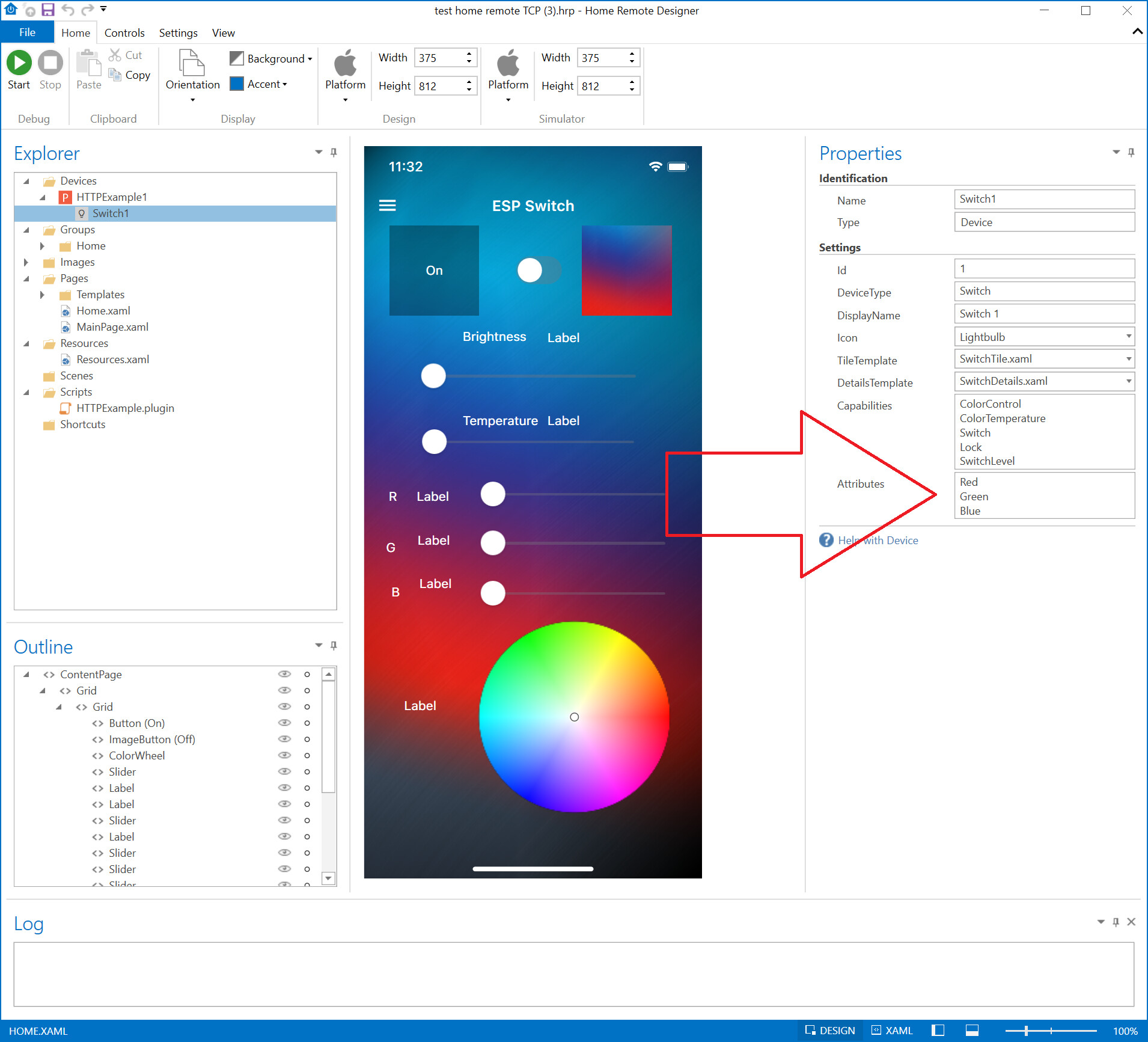

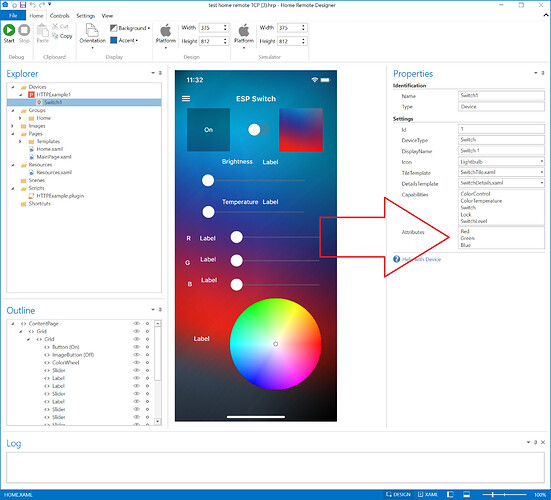

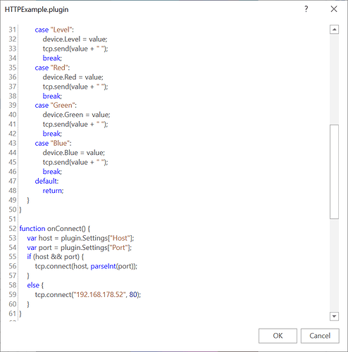

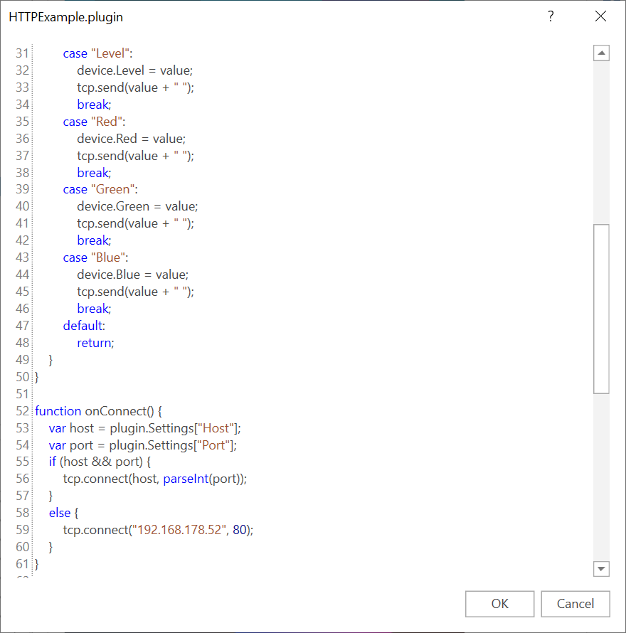

Use Attributes when a Capability for the thing you need isn’t available. See screenshots.

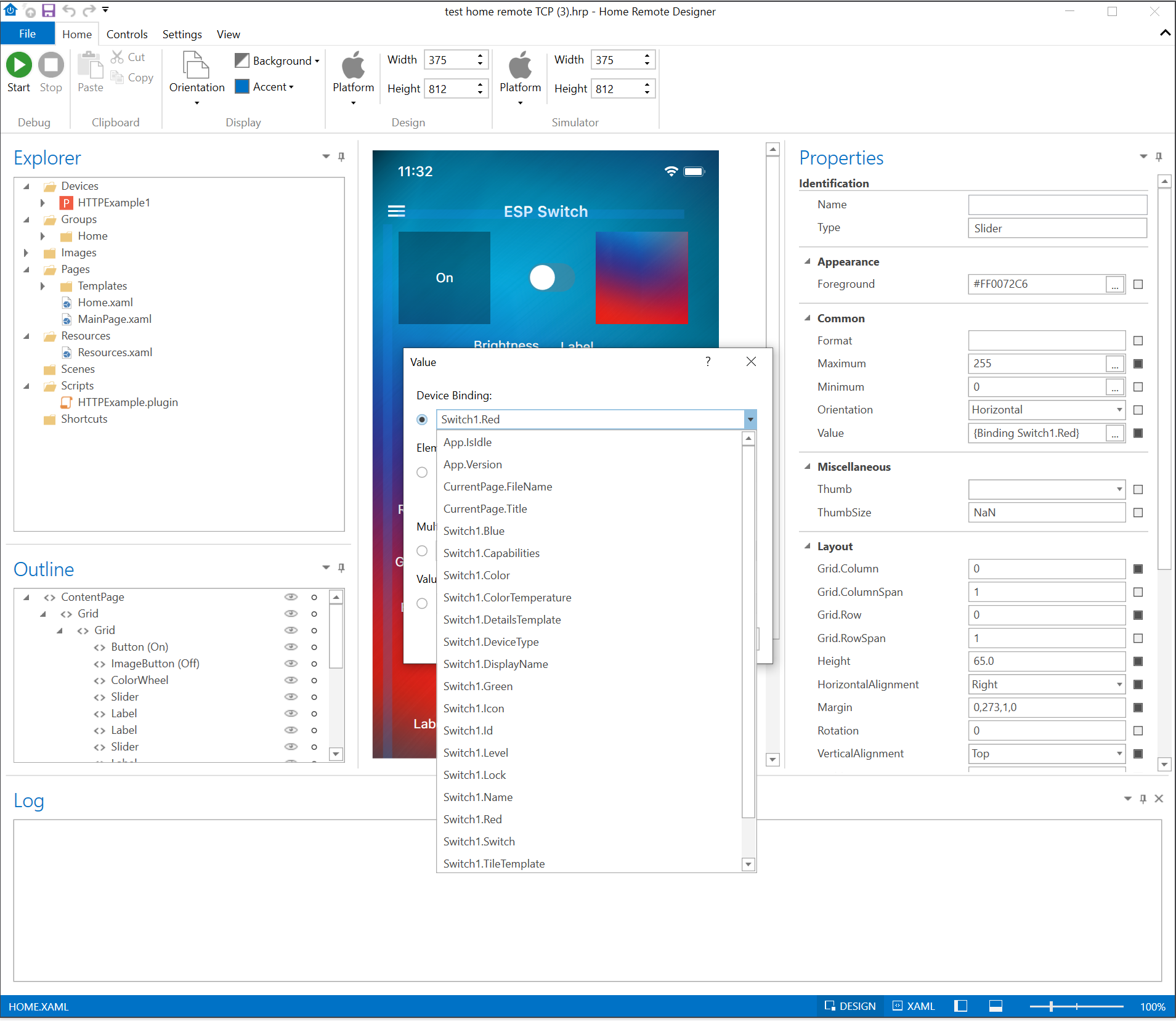

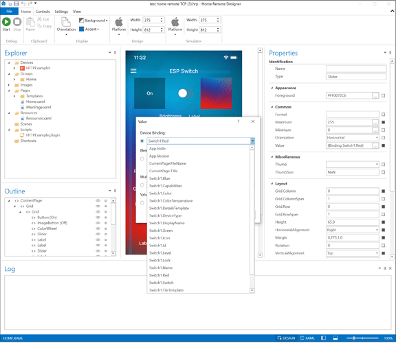

But how I do the device binding for the sliders now? In the dropdown menu I cant select the new attributes.

Set the binding of the sliders to Switch1.Red, Switch1.Green, Switch1.Blue.
I do see that those drop downs are not refreshing properly when entering new Attributes on the device object. You may have to close & reopen your project to see them in the drop downs.
Hello Bill,
yes, I tried that before.
I reopened the projekt and now it works!
