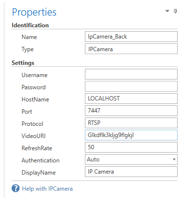

Unifi Cameras will work utilizing the built-in IPCamera Device Type:
Just fill in your IP address and the unique URI string generated by your protect controller.

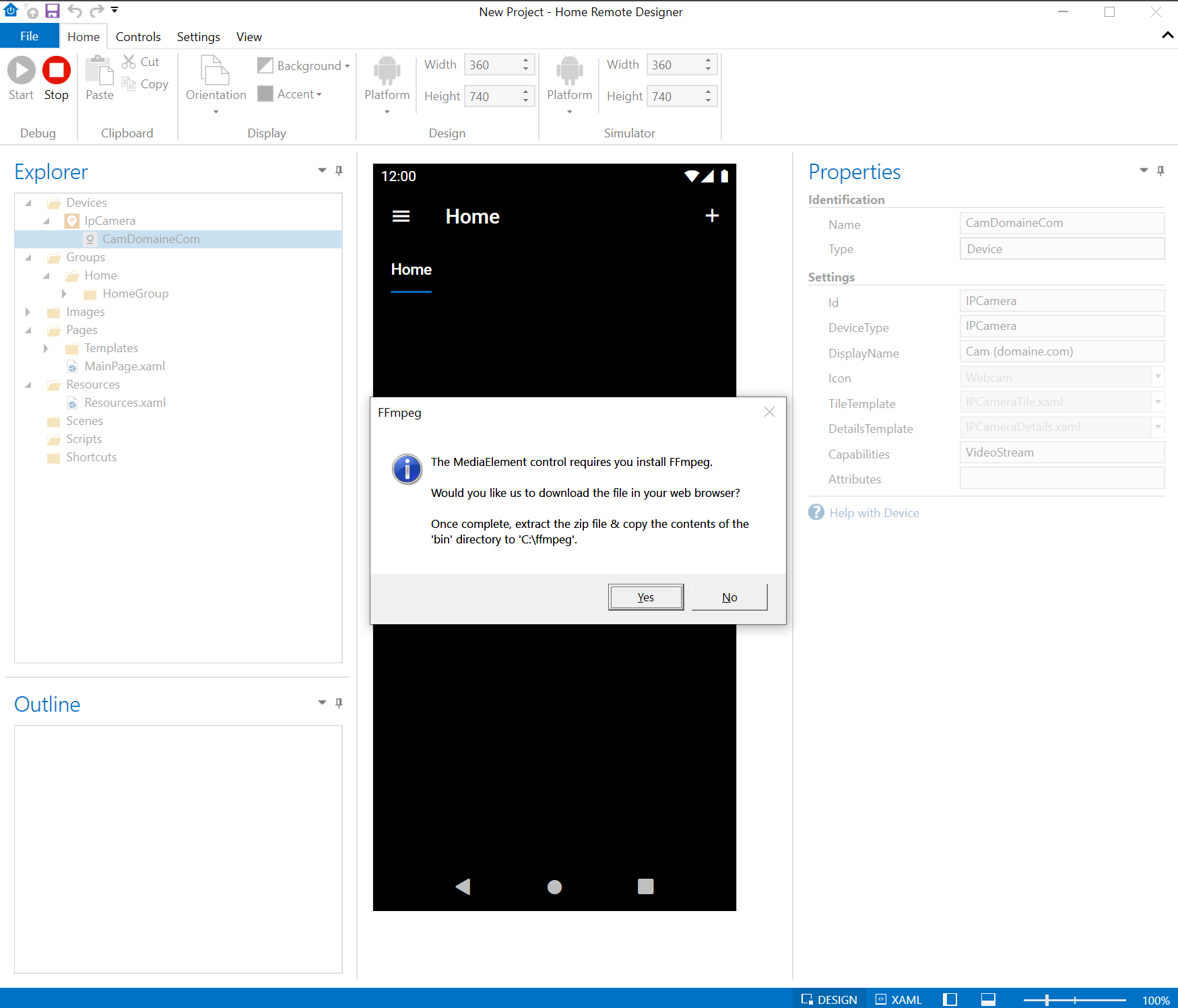

Did you download & install FFmpeg?
Are you running 32-bit or 64-bit Windows?
Those FFmpeg binaries are 64-bit. They won’t work on a 32-bit machine.
yes i installed the package when HR asked me.
I deposited in c: \ ffmpeg … but I can’t remember which version.
In theory, I should have chosen 64 bits (my system is 64 bits), but I will start the procedure again.
So I looked, the ffmpeg version is 64bits, windows also, the contents of Bin are deposited in c: \ ffmpeg but it does not work in the designer.
I deleted the file, HR offered to download it, I filed a second time. HR does not ask me anything more, it detects that the file is OK but does not display any cameras, but they are visible on the remote control of my smartphone.
