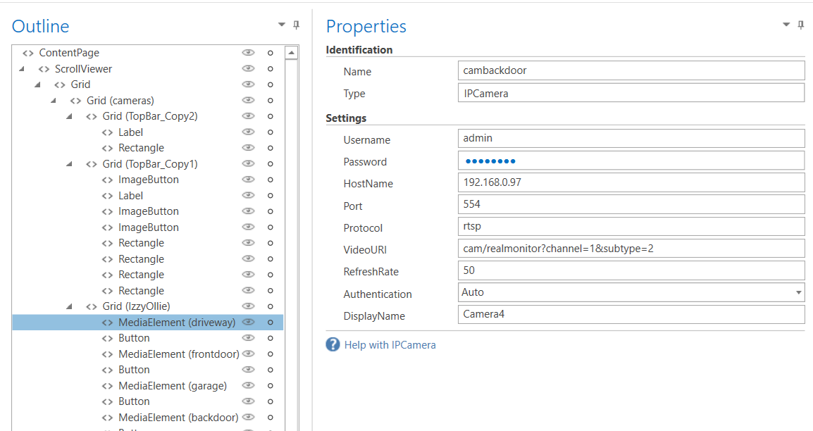

I have an android tablet that just updated the app and the IP cameras will not pull up now. I have an android phone that has not updated the app yet and the IP cameras are working as usual.
I’m not sure if it makes a difference or not but try capitalizing the Protocol “RTSP”.
Can you try resetting the app settings & adding the camera directly to the app?
I’d like to take the Designer out of the equation. That’ll help determine where the issue is. Either reinstall the app or load the attached SettingsReset.hrp file.

It was working in the designer, then I noticed my designer wasn’t up to date. I updated the designer and it stopped working in the designer. I removed the IP Camera devices I had and re-added them in the designer. HR was able to find all of my cameras via ONVIF and all is working now in the designer and in the app.
Yeah, I’d say definitely use the new ONVIF option that was added in this latest release if your cameras support ONVIF. That’s a bit cleaner & easier to manage. Not sure why the IP Camera device isn’t working for you. RTSP was completely overhauled in 4.2.0 & I did pretty extensive testing on both devices (IPCamera & ONVIF). Both are working fine for me.
