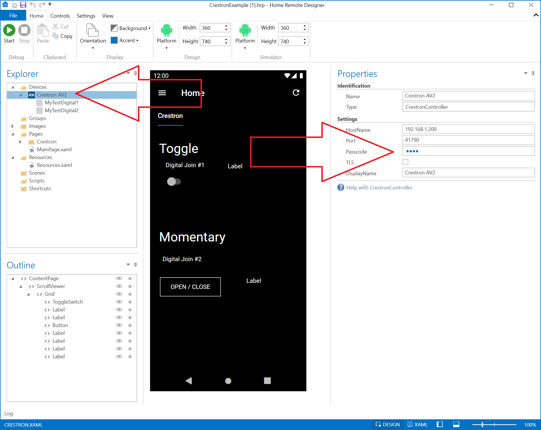

Both the passcode & IP address are set in the properties pane. Select the “Crestron AV2” object in the Devices folder then edit its properties.

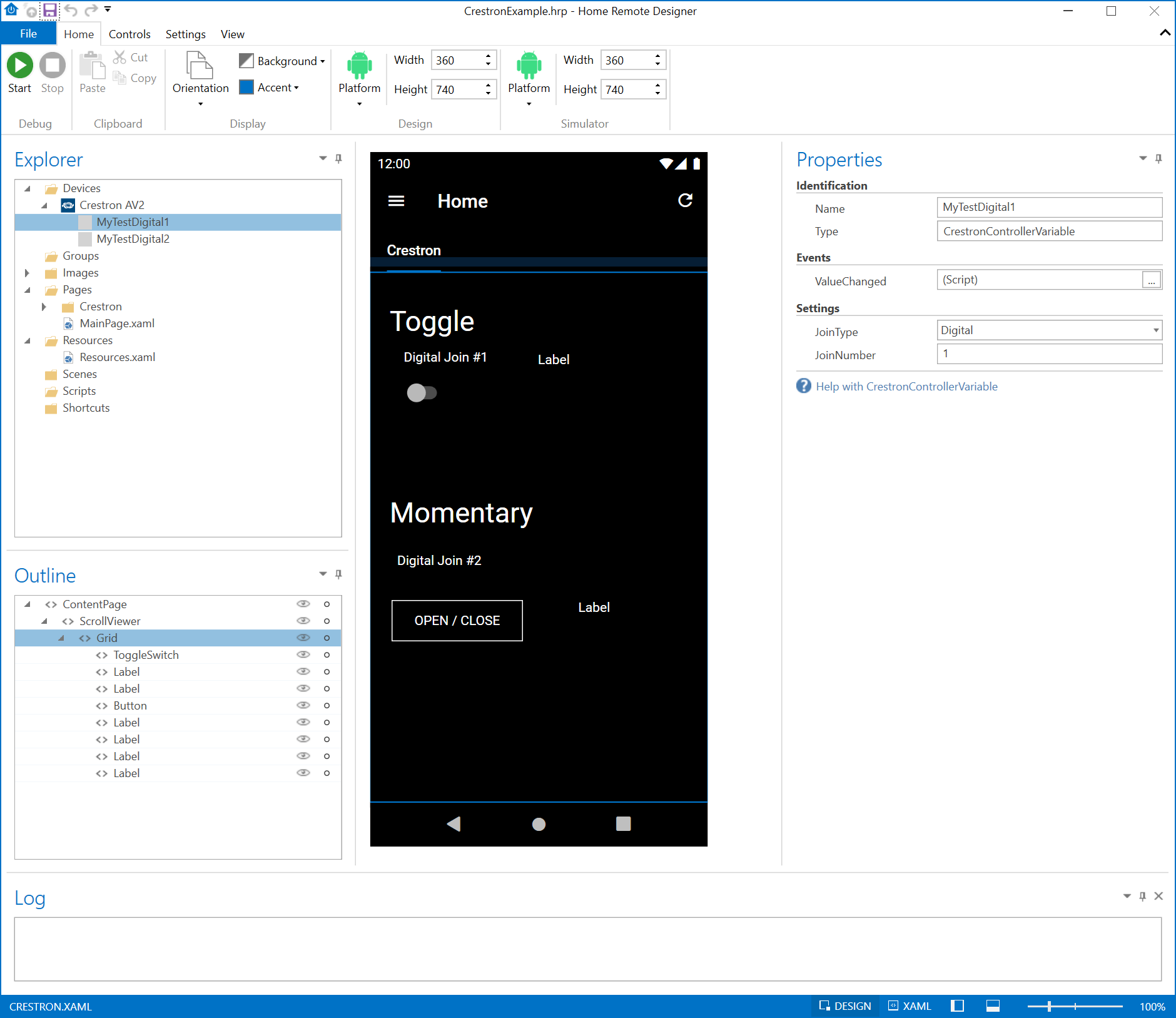

Here’s a link to a full example.

It may not be able to connect. I wouldn’t add a new controller. I’d recommend starting with that example I shared with you above. Then just edit the HostName, Port, & Passcode properties.
The IP address & Port you assign in the Properties pane should match that of the Crestron Mobile apps. It uses the “Crestron Mobile” SIMPL symbol to connect. So make sure those apps work 1st.
